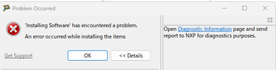

I performed the installation using "CodeWarrior for ARMv8 v11.5.0 b200629 Windows Offline Installer".
After that, I tried updating using CodeWarrior IDE by selecting Help → Install New Software → Add → Archive and specifying com.freescale.armv8.11.5.12.GA.Win.updatesite.221209.zip, but an error occurred during installation.
The error message is as follows:
KAZU_ISHI_0-1786959225115.pngKAZU_ISHI_0-1786959225115.pngKAZU_ISHI_0-1786959225115.pngKAZU_ISHI_0-1786959225115.pngKAZU_ISHI_0-1786959225115.pngKAZU_ISHI_0-1786959225115.pngKAZU_ISHI_0-1786959225115.pngKAZU_ISHI_0-1786959225115.pngKAZU_ISHI_0-1786959225115.pngKAZU_ISHI_0-1786959225115.pngKAZU_ISHI_0-1786959225115.pngKAZU_ISHI_0-1786959225115.pngKAZU_ISHI_0-1786959225115.pngKAZU_ISHI_0-1786959225115.pngKAZU_ISHI_0-1786959225115.pngKAZU_ISHI_0-1786959225115.pngKAZU_ISHI_0-1786959225115.pngKAZU_ISHI_0-1786959225115.pngKAZU_ISHI_0-1786959225115.pngKAZU_ISHI_0-1786959225115.pngKAZU_ISHI_0-1786959225115.pngKAZU_ISHI_0-1786959225115.pngKAZU_ISHI_0-1786959225115.pngKAZU_ISHI_0-1786959225115.png
An error occurred while installing the items
session context was:(profile=epp.package.cpp, phase=org.eclipse.equinox.internal.p2.engine.phases.Install, operand=[R]com.freescale.core.debugger.fsl_gdb13.0.0.202003111126 --> [R]com.freescale.core.debugger.fsl_gdb14.0.0.202204131357, action=com.freescale.updater.customactions.actions.FreescaleProcessCheck).
NLS missing message: param_not_set in: com.freescale.updater.customactions.Messages
Could you please advise me on how to deal with this?
Thank you very much for your understanding.

Re: LX2160AのJTAG(CCS)接続が失敗する
Please download my installation file from the following link, and reinstall CodeWarrior for ARMv8 11.5.12.
https://support.nxp.com/s/case/500Te00000eeSJXIA2/community-lx2160a%E3%81%AEjtagccs%E6%8E%A5%E7%B6%9...
Are you installing CodeWarrior for ARMv8 in Windows 10?
Please remove all your CodeWarrior installation file first.
Please install CW_ARMv8_v2020.06_b200629GA_Win_Offline.exe from my tar ball.
Then open CodeWarrior IDE in a new workspace, and install service pack com.freescale.armv8.11.5.12.GA.Win.updatesite.221209.zip from Help->Install New Software->Add->Archive.
Thank you for your reply.
Suspecting that the downloaded files might have been corrupted, I downloaded them again and attempted the updates as follows.
In Available Software Sites, I selected:
Add → Archive →
from the extracted download package.
After doing so, "CodeWarrior Updates" was added to the list, and I enabled only this update site.
To simplify the investigation, I then used Available Updates and installed the updates one by one, starting from the top of the list. The following updates failed with errors.
The error messages are listed below.
• CodeWarrior Debugger GTA 14.0.0.202212090959
An error occurred while installing the items.
operand=[R]com.freescale.core.debugger.gta 14.0.0.202006241928 --> [R]com.freescale.core.debugger.gta 14.0.0.202212090959,

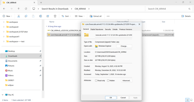

In addition please check the property of the service Pack, whether the size the same.
yipingwang_0-1788251622006.pngyipingwang_0-1788251622006.pngyipingwang_0-1788251622006.pngyipingwang_0-1788251622006.pngyipingwang_0-1788251622006.pngyipingwang_0-1788251622006.pngyipingwang_0-1788251622006.png
I didn't find obvious difference except the language setting.
Please edit C:\Freescale\CW4NET_v2020.06\CW_ARMv8\eclipse\eclipse.ini to add the following lines.
-Dfile.encoding=Cp1252
-Dsun.jnu.encoding=Cp1252
-Dorg.osgi.framework.language=en
Open CodeWarrior IDE with
C:\Freescale\CW4NET_v2020.06\CW_ARMv8\eclipse\eclipse.exe -nl en
Then try whether it is possible to do upgrade.
and then attempted the update using Help -> Install New Software.
However, the update still failed.
I have attached the error log file for your review.
I also noticed that some errors are already present in the log immediately after a fresh installation, before any update attempt. Could these errors be related to the update failure?
The attached log includes both:
- the initial startup after installation, and
- the subsequent update attempt performed via Help -> Install New Software.
