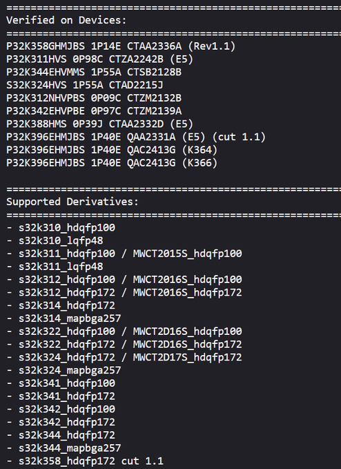

I found Bist_s32k342_hdqfp100.epd, eMcem_s32k342_hdqfp100.epd, and SafetyBase_s32k342_hdqfp100.epd inside the SPD plugins, which suggests S32K342 is supported. Could you confirm whether SPD 1.0.5 officially supports S32K342, and is
there a recommended (official) procedure or template for creating an S32K342 SPD project?

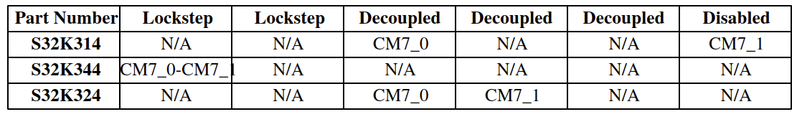

4. Lockstep configuration and confirmation
Does the S32K342 Cortex-M7 run in DCLS (Dual-Core Lockstep) mode? If so, how can I confirm at runtime that Lockstep is enabled, and how are RCCU mismatch errors mapped to the FCCU?

Hi @WuDiDi,
The recommended approach is to create a new project specifically for the S32K342 rather than porting an existing one.
The target derivative can be changed in the Resource module from the default S32K358 to the S32K342.
1.
Yes, SPD 1.0.5 supports the S32K342. Please refer to the SPD 1.0.5 release notes for details.

3.
Refer to this table:
https://community.nxp.com/t5/S32K-Knowledge-Base/DOC-S32K3x1-S32K3x2-S32K3x4-eMCEM-DCM-Mapping-v1-0-...
4.
Yes, lockstep is enabled, which can be checked in this register:
Read-Only GPR On Functional Reset 19 (DCMROF19[29])
Again, refer to the above table.
