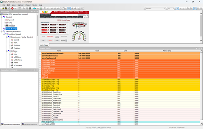

Hi Robin
Currently, regardless of whether it's the .srec file I compiled or the official example, it reports an overcurrent fault after the motor makes two beeps upon startup.
The fault interface is shown below, and the starting current captured by the external device is also shown below:
TimLIANG_0-1787020428889.pngTimLIANG_0-1787020428889.pngTimLIANG_0-1787020428889.pngTimLIANG_0-1787020428889.pngTimLIANG_0-1787020428889.png
TimLIANG_1-1787020447511.pngTimLIANG_1-1787020447511.pngTimLIANG_1-1787020447511.pngTimLIANG_1-1787020447511.pngTimLIANG_1-1787020447511.png
Re: S32DS K116编译问题
Hi Robin
I was busy with other things the other day. Mine is S32K116EVB2Q048.
Previously, the official example .srec files I downloaded all ran normally. Now, the three official projects I downloaded all have problems running the motor. Specifically, the download and communication are fine, but as soon as I set the speed and start the motor, it makes two beeps and then reports an overcurrent fault. In this case, do I also need to download the P&E Recovery Utility tool to halt the CPU and then download a new program?
Re: S32DS K116编译问题
Please first check whether the hardware circuit jumper cap conforms to the PMSM configuration according to the prompts on the Get Started with the MCSPTE1AK116 page.
