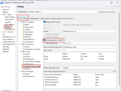

2. Run the Application from RAM
Please modify the project configuration to run the application from RAM:
2.1 Enable Link application to RAM:
2.2 Under Defined Symbols, configure:
XIP_EXTERNAL_FLASH=0
XIP_BOOT_HEADER_ENABLE=0
2.3 Rebuild the project.
2.4 Start a normal debug session and run the application.
Please let us know the results of both tests, especially whether the LED application can boot successfully from QSPI flash and whether the RAM-based application can run under debug.
