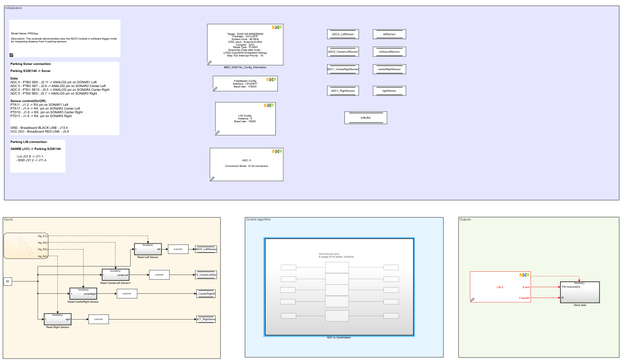

The parking sensor application is developed using a model-based workflow built around MATLAB, Simulink, Stateflow, and NXP's MBDT for S32K1xx devices. The Simulink model remains the main development artifact, while the supporting toolchain is used to generate code, build the application, download it to the target board, and monitor the running system.
3.1 MATLAB, Simulink and Stateflow
MATLAB and Simulink provide the main environment for developing the parking sensor application model. Simulink and Stateflow are used to organize the application structure, configure the processing blocks, and prepare the model for deployment on the S32K144 target.
Figure 1. PSS top-level model in Simulink

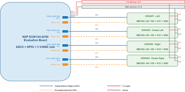

4.2 MaxBotix MB1020 Ultrasonic Sensors
The demo uses four MaxBotix MB1020 sensors, also known as LV-MaxSonar-EZ ultrasonic sensors. Each sensor provides an analog voltage output that varies with the measured distance, which makes the device easy to connect to the S32K144 ADC inputs. The sensor also includes an RX pin that can be used as an enable or control input.
4.3 Sensor Wiring and Pin Mapping
Each MB1020 sensor is connected to the S32K144-Q100 board using two main signal types. The analog output pin is connected to one ADC input channel, while the RX pin is connected to a GPIO output and can be used by the application to control the sensor. Power and ground are distributed from the evaluation board through the breadboard.
The following pin mapping comes from the PSS model connection annotation.
Sensor Analog pin to S32K144 RX enable pin to S32K144
SONAR1 — Left AN → PTB2, ADC0_SE6, J2.11 RX → PTA11, J1.2
SONAR2 — Center Left AN → PTB3, ADC0_SE7, J2.9 RX → PTA17, J1.4
SONAR3 — Right AN → PTA0, ADC0_SE9, J5.7 RX → PTD10, J1.6
SONAR4 — Center Right AN → PTA1, ADC0_SE15, J5.5 RX → PTD11, J1.8
Power and ground connections are defined as follows.
Signal Connection
GND Breadboard black rail → J13.4 on S32K144-Q100
VCC 5 V Breadboard red rail → J3.9 on S32K144-Q100
Figure 4. Sensor Wiring Between the S32K144-Q100 Board and MB1020 Sensors
