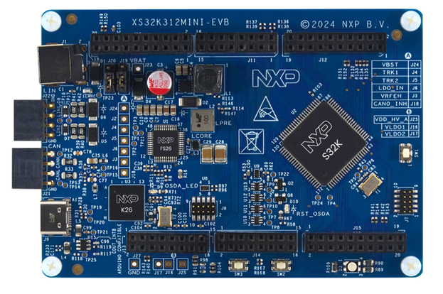

4.1. FRDM Automotive S32K312 Development Board (FRDM-A-S32K312)
The front and rear lights application runs on the FRDM Automotive S32K312 Development Board, a development platform based on the NXP S32K312 microcontroller. The board provides access to the communication interfaces and processing capabilities of the target device while offering an integrated platform for software development, debugging, and validation activities.
Within the scope of this project, the board is used to execute the lighting application and exchange messages with the central controller through the CAN network. Its communication interfaces, debugging connectivity, and expansion capabilities make it suitable for evaluating body electronics use cases and lighting control scenarios.
Figure 4 - FRDM Automotive S32K312 Development Board
