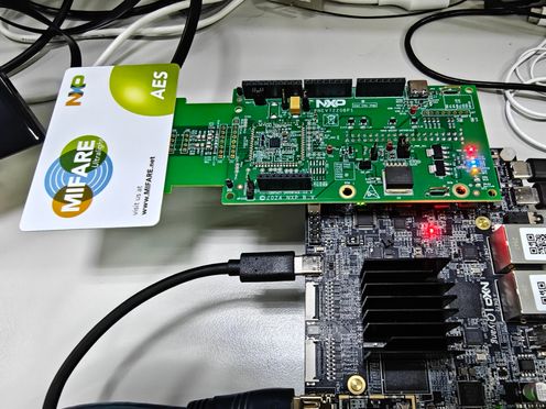

Hardware boards:
i.MX95 FRDM Board (FRDM i.MX 95 Development Board | NXP Semiconductors)
PN7220 EVK -- PNEV7220BP1 (PNEV7220BP1 Development Board for PN7220 NFC Controller | NXP Semiconductors)
There is a 40pins connector on both PN7220 EVK and i.MX95 FRDM board. So PN7220 + i.MX95 FRDM connecting together is like this:

Here is the 40 pins connector on the PN7220:
Here is the 40 pins connector on the i.MX95 FRDM board.
According to the 40 pins connection between PN7220 EVK and the i.MX95 FRDM board, I decided to use the I2C6 and the GPIO2_20, GPIO2_21 and GPIO2_26.

Run the "TagInfo" on the board:
- Download the TagInfo apk file from the NXP TagInfo App web page .
- Use the "adb install" command to install the TagInfo to the FRDM board.
C:\>adb install com.nxp.taginfo-6.2.0-play-release-protected.apk
* daemon not running; starting now at tcp:5037
* daemon started successfully
Performing Streamed Install
Success
After TagInfo installed, the TagInfo icon will be available on the GUI.
Run the TagInfo, and then put a card on the board.
The information of the card will be show on the TagInfo App.
