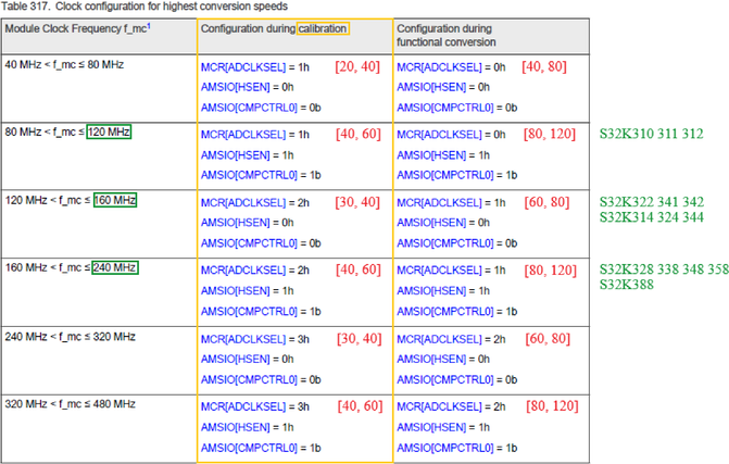

Hi@Stark_
Based on the configuration screenshot you provided, there are some configuration issues, specifically the division ratios for the module clock and calibration clock.
The ADC clock configuration must strictly follow the table below.
please change it and test  again,

Hi@Stark_
I've already show you of my test results, and you should have noticed that the fluctuations in my sampling results are perfectly normal.
My suggestion is that you could try increasing the sampling time, as I previously suggested.
