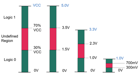

How I²C logic levels really work
I²C does not use fixed voltages like 0 V or 5 V to define logic states. Instead, it uses thresholds relative to VCC:
  • Logic 0 (LOW): below ~30% of VCC
  • Logic 1 (HIGH): above ~70% of VCC
  • Undefined region: between 30%–70% → signal is unreliable
In real systems, signal levels may not behave ideally.
Due to:
  • Different driver strengths
  • Load variations
  • Buffer offset behavior
You may observe three voltage levels, even though the protocol only defines two logic states.
This can lead to misinterpretation of signals.
We will explore this behavior in more detail in the following sections, especially when analyzing how I²C buffers and offset mechanisms work.

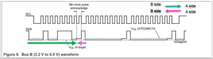

Static Voltage Offset introduces an intentional voltage offset, so a LOW level is not always represented by 0 V. Instead, the buffer creates two valid LOW levels, both within the I²C specification. To achieve this, the input and output logic levels on the special side of the buffer are intentionally designed to be different.
The key concept is that the special output LOW voltage (VOL) is set slightly higher than the corresponding input HIGH threshold (VIH):
For example:
  • Special output VOL ≈ 0.7 V
  • Special input VIH ≈ 0.55 V
When the buffer drives the special side LOW at approximately 0.7 V, that voltage is still considered a valid LOW by other I²C devices on the bus. However, for the buffer's own special input, 0.7 V is interpreted as a HIGH because it is above its VIH threshold.
As a result, the buffer's output cannot feed back into its own input, preventing the latching condition commonly found in simple bidirectional buffers.
This enables the buffer to distinguish between two conditions:
  • State 1:
    • The voltage is between the special input threshold (VIL) and the offset level (VOL/SVO).
    • This indicates that the LOW originated from one side of the buffer.
  • State 2:
    • The voltage is pulled much closer to 0 V, below the special threshold.
    • This indicates that the LOW originated from the opposite side of the buffer.
By monitoring these voltage levels, the buffer can determine where the LOW signal originated (Side A or Side B). Once the direction is identified, the buffer can correctly propagate the signal to the other side while avoiding feedback, latching, and communication conflicts.

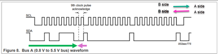

Case 1: LOW originated from the Non-Offset side (A → B)
A device on Side A pulls the line LOW.
The buffer propagates this LOW to Side B while adding the static offset:
Side A = LOW
Side B = LOW + Offset
As a result:
  • Input = LOW
  • Output = OFFSET
The presence of the offset voltage indicates that the signal originated from the Non-Offset side and is being propagated toward the Offset side.
Case 2: LOW originated from the Offset side (B → A)
A device on Side B pulls the line LOW.
The buffer recognizes that the voltage has been driven below the offset threshold and propagates a true LOW toward Side A:
Side B ≈ LOW
Side A ≈ LOW
As a result:
  • Input = LOW
  • Output = LOW
The absence of an offset on the output indicates that the signal originated from the Offset side and is being propagated toward the Non-Offset side.
INPUT OUTPUT DIRECTION
LOW LOW B SIDE TO A SIDE
LOW OFFSET A SIDE TO B SIDE
