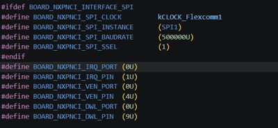

Sorry I was away a bit on other project, here is the latest screenshot. which i have difficult in compile the #include
Shakir Salam

Re: Migration Guide of NXP-NCI 2.0 SPI examples with PN7160 for MCXW23 in Visual Studio Code
Hello @S_Salam555, hope you are doing well.
From the images that you shared from your project, it seems that you are trying to configure SPI with MCXW71 specific configurations which are different from the MCXW23's.
Both drivers need different configuration requirements among them, for this I would suggest that you refer to any polling SPI example from the MCXW23 SDK. I would not suggest to just copy and paste the initializations nor the files from one project to another, rather, adapt the configurations to how your project is built in the TML layer to initialize the SPI peripheral and send and receive data.
Hope this helps!
Hello @RomanVR ,
I already changed the connection and avoided using pin 10 on header J2 as suggested. it able to output to tera term. However, the garbled data is still present when connecting the PN7160 EVK.
Please let me know if there are any other pins or configurations that I should verify.
Shakir Salam
Hello @S_Salam555.
Please consider that if you are using pin 10 of header J2 of the board as one of the GPIOs needed for the communication with the PN7160, since this pin is connected directly to the reset of the MCU, you might be causing the MCU to reset when connecting the NFC EVK, for this you need to use another pin from another header of the board and do the connections with jumpers.
Please let me know if you are using the pin that I mentioned above.
