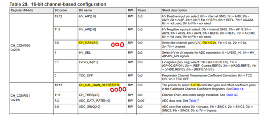

Hello, I'm having a problem configuring the NAFE73388. The device seems to respond correctly to the configuration and the commands we send it:
We write to the configuration registers, and when we read them back, we get exactly the values we wrote.
The conversion commands (SCSR/SCCR) are accepted, and the ADC performs conversions in the different modes; we’re setting the pointer to 0 (CH_CAL_GAIN_OFFSET) so it uses the Nafe’s default configuration for the mode we’re setting.
The SPI frames we observe on the MISO line correspond to consistent and repeatable data between conversions (we are verifying them directly with the oscilloscope).
If we invert the input polarity, the ADC also returns the corresponding negative value.
The problem we are observing is as follows:
When we configure the channel in single-ended mode with gain = 0.2, the ADC saturates at approximately ±5 V, returning the maximum code (≈ 0x7FFFFF). According to the datasheet, with this configuration we would expect saturation around ±10 V.
That is:
Below ~±5 V, the measurements appear correct.
Above ~±5 V, the ADC begins to saturate.
We would like to confirm whether there might be any additional configuration aspects that are limiting the effective input range (for example, a system register, input mode, or a specific condition of the HV path or ADC PGA), or if there are any specific considerations we should take into account to achieve the full expected range with gain = 0.2.

Yes you are right at gain=0.2 the part supports +/-10V in single ended mode as defined in the input range table of EC. Our EVB support all these input range conversions. What hardware are you using?
the below registers parameter (highlighted yellow) value as 000 & 0000 (written below):
Can you please clarify what you means by “the ADC performs conversions in the different modes”
The factory Gain & offset coefficients for each gain are saved in specific pointers as mentioned in table 12. The pointer location in Ch_Config1is selected in accordance to Table12 to use correct factory coefficient for particular gain setting/input range. So if you are using gain=0.2x(VIN_SE=10V) in CH_CNFIG0, then the factory cal pointer 0 should be used CH_CONFIG1-> CH_CAL_GAIN_OFFSET[3:0]=0000 as per table 12. Similarly, for gain=0.8x (VIN_SE=+/-2.5V), set CH_CONFIG0->GAIN[2:0]=010 and CH_CONFIG1-> CH_CAL_GAIN_OFFSET[3:0]=0010.
If above pointer is correct, then we need to know the Gain and offset coefficient dialed in the below registers.
If above is all correct, can you readback the Alarm registers right after the saturated conversion code are captured.
Please also share the information on input setup – source of input, any circuitry at the input channel, are they measuring the voltage at the input pins of the channel they are converting? Is this issue happening in all conversion modes – SCSR, SCCR, MCSR, MCMR?
