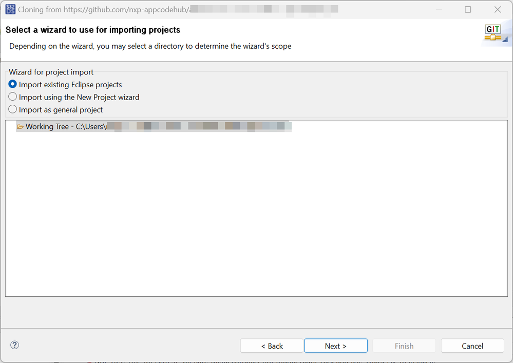

3.1 Import the Project into S32 Design Studio IDE
  1. Open S32 Design Studio IDE, in the Dashboard Panel, choose Import project from Application Code Hub.
  2. Found the demo you need by searching the name directly. Open the project, click the GitHub link, S32 Design Studio IDE will automatically retrieve project attributes then click Next>.import_project_2.pngimport_project_2.png
  3. Select main branch and then click Next>.
  4. Select your local path for the repo in Destination->Directory: window. The S32 Design Studio IDE will clone the repo into this path, click Next>.
  5. Select Import existing Eclipse projects then click Next>.
  6. Select the project in this repo (only one project in this repo) then click Finish.
