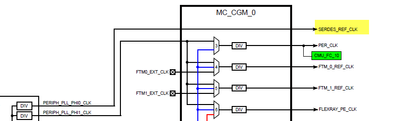

I am currently debugging PFEMAC using my own board. Now I have encountered a problem. When I initialize the serdes in the APP program, the PFEMAC communication is normal. Since I want to start both the M core and the A core simultaneously, I need to move the serdes initialization to the bootloader. However, when I put the serdes initialization in the bootloader and remove the serdes initialization from the APP, and start the M core alone, the PFEMAC stops working properly. I wonder how else I can troubleshoot this issue?sdx111_0-1769047758430.png

1. You can check if this PHI0 is configured consistently in Clock Configuration, which is the Serdes reference clock object, and if the clock is configured again in the M-core, checking the box Under the control of the MCU may configure the clock again, resulting in an impact on the initialization of the previous Serdes.

Re: Problems with the PFE MAC debugging of the S32G2741.When booting the M7 APP in bootloader, the clock initialization will not be kept in the M7 APP, it is just that I am debugging the PFE MAC now, and it is going to be removed in the end.
2.The .c and .h files of serdes configurations in the bootloader are copied directly from the app.
3.I have observed the same reference clock in the M7 APP through debugging the bootloader and M7 APP to observe the reference clock of serdes is the same

1.After SerDes is initialized, MUX for SerDes clocks provided to PFE/GMAC has to be changed again. Because when the MUX switches the source clock, the source clock must be ready, which is the hardware limitation.
2.If you still have the clock initial in the M7 application when you use the bootloader to boot M 7 core. Could you have a test to put Serdes initial in M7 app for using the bootloader to boot?

Re: Problems with the PFE MAC debugging of the S32G274I performed the clock initialization in the M7 core. After the serdes initialization, I also included the clock initialization. From the screenshot of the bootloader above, the function is SysDal_McuPlatformInitSeq(); It included the initialization of the clock, but it still didn't work.
Also, I would like to know why a second clock initialization is required after the serdes is initialized?

Re: Problems with the PFE MAC debugging of the S32G2741. After initializing the SerDes, the SerDes clock MUX provided to the PFE/GMAC must be changed again because the source clock must be ready when the MUX switches the source clock, which is a hardware limitation.
As mentioned here, the SerDes clock MUX supplied to the PFE/GMAC must be changed again, can you tell me in detail what registers are included?
