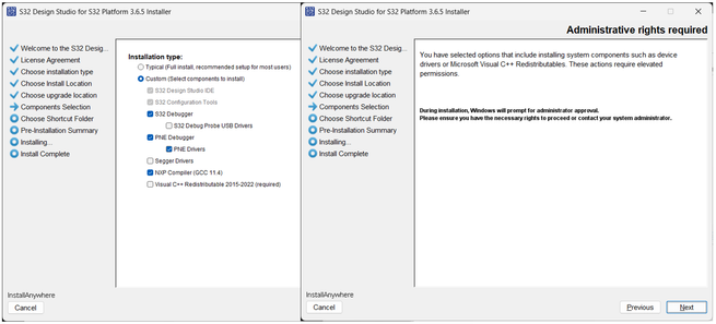

  • S32 Design Studio 3.6.5 is delivered with all public NPI's in a single 2.63GB installer to improve first time user experience. Additional packages for alpha customers are available based on Flexera entitlement and can be installed on top of S32 Design Studio 3.6.5 using Extension and Updates.
  • Installer will require admin rights only when the user chooses to install components which need elevation (Visual Studio Redistributable or debugger drivers). If a user chooses a custom installation only with S32DS IDE and its components (no drivers) the installation will finish without admin rights.

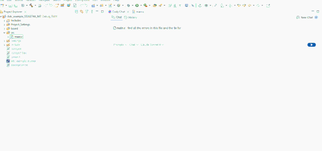

  • Integrated Cody, the open-source Eclipse plugin from Sourcegraph, into S32 Design Studio. This plugin is installed by default, allowing users with a valid Cody license to log in directly within S32DS and access Generative AI features. Note: Users must agree to the Sourcegraph Terms of Service before using Cody.
