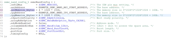

Hi. I am working on a feasibility study for using RT1170 with NAND flash as a telemetry storage. On the evaluation board MIMXRT1170-EVKB there is MT29F2G08ABAGAH4 NAND flash with 2Gb of storage. There is an example in the SDK called evkbmimxrt1170_flash_component_nand_semc_cm7 which demonstrates working with the memory. This example is great and works perfectly.
Now our goal is use this MCU (specifically MIMXRT1176CVM8A) on a custom board with large NAND flash MT29F64G08AECABH1 with 64Gb split into 2 dies with 32Gb each, as this picture from the datasheet shows. For the time being in the asynchronous mode.
2025-11-30 21_28_11-Data Sheet_ 32_64_128_256Gb Async_Sync NAND (M73A) - nand_memory_datasheet.pdf —.png2025-11-30 21_28_11-Data Sheet_ 32_64_128_256Gb Async_Sync NAND (M73A) - nand_memory_datasheet.pdf —.png
Can you please advise me on how to achieve that? How must the SDK example be modified to allow working with this memory?
Thank you in advance. Best regards Vojtech.

alright, I see your point. Let me put my request for support differently. Let's say I only want to use the die 1 with one LUN, and the second one totally unconnected and forgotten. The die 1 will be connected the same way as the NAND flash on DevKit, with CE# driven by SEMC via the same pin as in the example. So I am basically just replacing the 2 Gb NAND flash from DevKit with the 32 Gb half of the chip from the same family whose part number I mentioned previously.
Now, please, what are the steps I need to take in rewriting the example to work properly with this new NAND flash?
Thank you. Best regards Vojtech.
Re: Using larger NAND flash than on MIMXRT1170-EVKB
Hi @VojtechBaranek ,
Yes, you are right! For the chip you selected, I think kSEMC_NandColum_13bit should be used for the columnAddrBitNum.
Kan
Hi @Kan_Li ,
that makes sense for the fields you mentioned. But shouldn't also columnAddrBitNum be extended?
Best regards, Vojtech.
If so, I think you just need to update the memory size as below:
Kan
