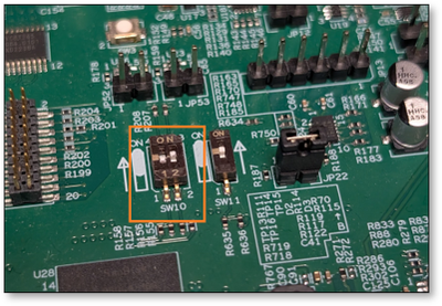

  6. Install the latest LinkServer CMSIS-DAP debug firmware on your board by putting a jumper on JP20, unplugging and plugging in the micro-USB cable on J54, and running the C:\NXP\LinkServer_\MCU-LINK_installer\scripts\program_CMSIS.cmd script. Then remove the jumper and do a power on reset.

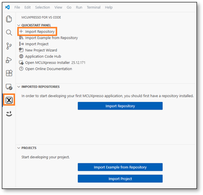

  2. Go to the MCUXpresso for VSCode plugin and click on Import Repository
  3. anthony_huereca_4-1786510398165.pnganthony_huereca_4-1786510398165.pnganthony_huereca_4-1786510398165.png
