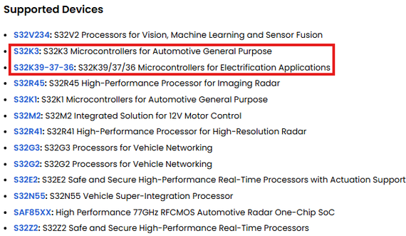

Hi team,
The "S32 Debugger for S32 Platform" mentions that S32K3 also supports the S32 Debug Probe.
But when I check the "S32DS Extensions and Updates" in the S32DS IDE 3.5, I found that the S32Z2/E2/G/R development package all support the S32 Debug Probe, but for S32K3 development package, it seems not supporting this feature.
Could you please check whether S32K3xx can support the S32 Debugger? If supported, please share the environment (S32DE IDE version and corresponding development package download link) for integrating this feature.

Hi @ZhengLin ,
The S32 Debugger support for S32K3 devices is available with S32DS3.6. In S32DS3.5 such support does not exist. Please install S32DS3.6.3, the most recent release; is a new installer that will have default also the S32K3 dev packages (actually all the public NPIs will be default installed with the S32DS3.6.x installer).
