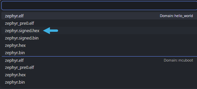

Debugging the app will not program the MCUboot image to the flash.  But we can flash either image to the board using VS Code.  In the Projects view, right-click the project and select Flash the Selected Target.
In the pop-up at the top of the window, select the zephyr.hex file in Domain: mcuboot.  VS Code will flash that zephyr.hex file to the board.
Now you we can debug or flash the app.
