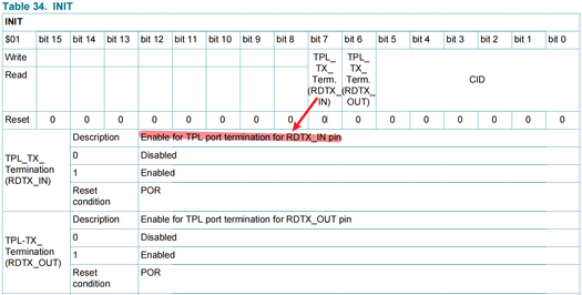

在MC33771C的INIT寄存器中有2个位的解释在NXP的两份文档中对TPL_TX_Term的解释不一致,请问以哪一个为准?
1.Rev. 3.0 — 11 July 2019的datasheet中,描述如下:
2.在Rev. 1 — 30 September 2021的AN13281应用笔记中描述又是这样的:

Hi ZDDL
以datasheet 为准:
看下面的用法:
"RDTX_IN" and "RDTX_OUT" are both corresponding to one TPL line (input/output) on the IC.
Even though they are called IN and OUT, they are both symmetrical.
Only one of the two TPL_TX_Term (RDTX_IN or RDTX_OUT) should be set to 1 in the case of a single ended daisy chain. The one set to 1 should be the TPL line that is not used.
This way, if the last node is connected to the chain through the RDTX_IN line, then TPL_TX_Term (RDTX_OUT) should be set to 1 and vice-versa.
Also note that in case of double-ended chain (also called loopback), neither TPL_TX_Term should be 1.
