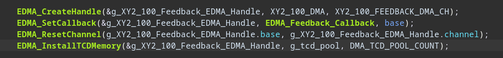

I'm using SDK 2.16.100 and rt1062 MCU.
I encountered a problem when using DMA
I setup a tcd pool, and submit transfer with 2 or 3 configs to DMA channel 1, and when the edma callback is called , I found the TCD1 is all cleared to 0. When I only submit only one config, and after the edma callback is called, the TCD1 is remained.
Following is my code snippets:
Define global tcd pool
__attribute__((section(".bss.$SRAM_OC"))) edma_tcd_t __ALIGNED(4) g_tcd_pool[DMA_TCD_POOL_COUNT];
In my DMA setup Code:
	EDMA_CreateHandle(&g_XY2_100_Feedback_EDMA_Handle, XY2_100_DMA, XY2_100_FEEDBACK_DMA_CH);
	EDMA_SetCallback(&g_XY2_100_Feedback_EDMA_Handle, EDMA_Feedback_Callback, base);
	EDMA_InstallTCDMemory(&g_XY2_100_Feedback_EDMA_Handle, g_tcd_pool, DMA_TCD_POOL_COUNT);

Re: TCDx Register is cleared out when using TCD Pool in RT1062 with SDK
Thanks, I used the definition from example, it worked then.
Hi @sprhawk ,
Thank you so much for your interest in our products and for using our community..
Please check the following code.
1:  Please refer to SDK Demo "evkbmimxrt1060_edma_scatter_gather"
2: I suggest you add function EDMA_ResetChannel, just as SDK demo do.
Please check above.
Wish it helps you.
Wish you a nice day!
Best Regards
MayLiu
