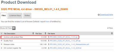

Thank you for looking into this issue. Actually, I am using D2306 now. I re-copied everything and attached the output from the make generate command. There was an error indicating that the folder already exists, followed by some warnings. After generating, I encountered a missing file error when running make build.
