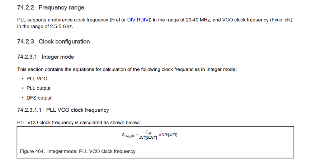

  • Clock configuration :
		 * Fvco = (Fref / rdiv) * (MFI + MFN / MFD)
		 * Fout = Fvco / odiv
		 * The (Fref / rdiv) should be in range 20MHz to 40MHz
		 * The Fvco should be in range 2.5Ghz to 5Ghz

From documentation of imx93:
  • Clocks : tested with 3 clocks x4, x5, x6
