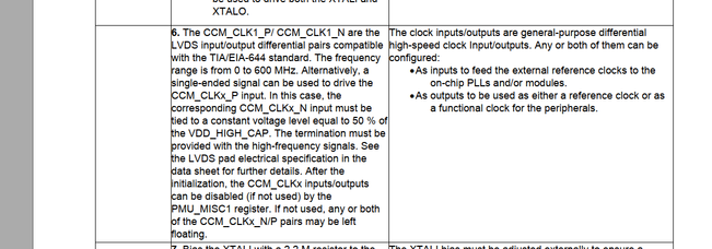

CCM_CLK1_N/P pads P16 and P17 on imx6 MCIMX6Y2 how to use as an output?
The picture above is from document number: IMX6ULLHDG.
It states that CCM_CLKx_P/N can be used as an output.
How can this be done? The IMX6 reference manual does not even mention CCM_CLKx_P/N. Can someone post the steps to set them as outputs and rout an internal clock to them?
NOTE: I am not talking about CCM_CLKOx!! I am talking about CCM_CLK1_N/P pads P16 and P17 on imx6 MCIMX6Y2.
Thank you.
Re: CCM_CLK1_N/P pads P16 and P17 on imx6 MCIMX6Y2 how to use as an output?I was able to output XTAL. Thank you.Re: CCM_CLK1_N/P pads P16 and P17 on imx6 MCIMX6Y2 how to use as an output?
Hello @Kevin16
I hope you are doing well.
This can be configured from LVDS1_CLK_SEL and LVDSCLK1_OBEN:
