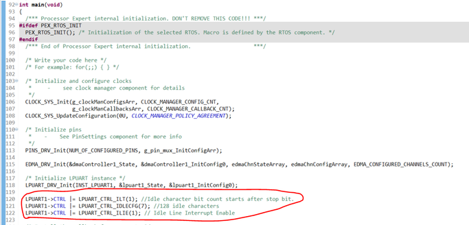

-5 configure IDLE releated register in main function.
  LPUART1->CTRL |= LPUART_CTRL_ILT(1);
  LPUART1->CTRL |= LPUART_CTRL_IDLECFG(7);
  LPUART1->CTRL |= LPUART_CTRL_ILIE(1);

          The baud rate of the serial port is set to 19200, and the function implemented is to send back the received data using DMA methods
