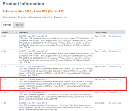

Then, select "My NXP Account > Apps and Services":
Then select "Software Licensing and Support":
From the Product List, select "Automotive SW - S32G Reference Software"
Then, from the Product Information select "Automotive SW - S32G - Linux BSP (Cortex-A53)":
Select the version corresponding to your BSP and board:
Accept the Software Terms and Conditions.
Finally, download the User Manual:
You may find a similar table on page 51:
