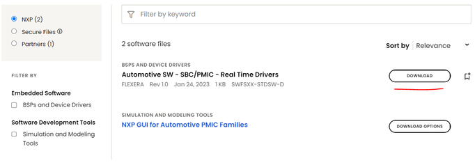

How to install FS26 packages for S32k3?
I want to install FS26 packages but I am unable to find it in install tab in s32
Re: How to install FS26 packages for S32k3?
Hi@pranav_prabhu
First download the FSxx version corresponding to the RTD version you are currently using, then
you can install it in the “S32 DS->Help->Install New Software” interface
https://www.nxp.com/products/power-management/pmics-and-sbcs/system-basis-chips/safety-system-basis-...
