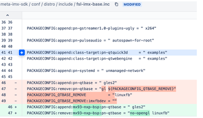

Hi @Zhiming_Liu
As you mentioned, I made the changes according to the picture, but when I executed the command "bitbake -k imx-image-full -c populate_sdk" 、 "bitbake -k imx-image-full"
ERROR: Task (/home/zmj/imx-yocto-bsp/sources/meta-qt6/recipes-qt/qt6/qtdatavis3d_git.bb:do_install) failed with exit code '1'
ERROR: Task (/home/zmj/imx-yocto-bsp/sources/meta-qt6/recipes-qt/qt6/qt3d_git.bb:do_install) failed with exit code '1'

Re: imx6ull bitbake qt3d failed with latest yocto 6.6.3 BSP
The previous patch is only for i.MX93. L6.6.23 will fix this issue for all platforms.
For i.MX6ULL and other, need patch again. Please replace meta-imx-sdk/conf/distro/include/fsl-imx-base.inc with below content directly. Then reserve DISTRO_VERSION, this DISTRO_VERSION is for L6.6.23.

Hi  @Zhiming_Liu
As you mentioned, I made the changes according to the picture, but when I executed the command "bitbake -k imx-image-full -c populate_sdk" or "bitbake -k imx-image-full", the error in the following picture would appear. Even using "bitbake-c cleanall qtdeclarative" does not resolve the error.
If you are using i.MX93, you need modify below file
The same issue about other i.MX product which doesn't support opengl will be fixed in next BSP.

Hi @zhimingqiu
I tried to do this but still got the same error generating the sdk phase.I think that approach is wrong, Two FAE in China also encountered the same problem
Hi @2458332461
You can remove these packages in sdk and image. They require opengl.
Hi @Nobita
This could relate to this flag, as i.MX93 has g2d, so 'no-opengl' flag will work. You can try to add it in PACKAGECONFIG_PLATFORM = ""
