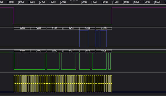

I use the official nxp sample program to wake up 772c and code for it with SPI, the process is
#1 nop = {0, 0, 1244}
#2 wait 500us = {5000, 0, 0}
#3 nop = {0, 0, 1244}
#4 loca write INIT-register = {3, 256, 1660}
It is executed normally in PCB-A
The feedback message code (@ corresponds to #) is
@1= {0, 0, 96}
@3 = {0, 0, 4302}
@4 = {0, 0, 8211}
But in PCB-B all three replies are
{0,0,61624} = {00 00 00 00 F0 8B}
The logic analyzer waveform is shown in the figure

Messages having less or more than 48 bits, incorrect CRC, or incorrect SCLK phase are disregarded. Communication faults set the COM_ERR_FLT fault bit in the FAULT1_STATUS register and increments the COM_STATUS[COM_ERR_COUNT] register.
Could you please share a detailed description of the bits sent based on the image  below? Are you following such procedure?
Note that after a power-up (POR) or RESET (pin) or SYS_CFG1[SOFT_RST], the MC33772C device only responds to the cluster ID of 00 0000b. The user must change the cluster ID of the device by writing a new cluster ID into register INIT[CID].
