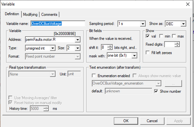

i cut the short-circuit line of J15 on DEVKIT-MOTORGD board so i can power the board and S32K144 board with an 24V adpter and driving a 24V PMSM. but i got UDC-HI error with below settings,how to set the voltage limitation for MCAD.
#define I_MAX (31.25F)
#define U_DCB_MAX (45.0F)
#define N_MAX (3500.0F)
#define WEL_MAX (1099.56F)
#define E_MAX (36.0F)
//Application Fault Triggers
#define U_DCB_TRIP (40.0F)
#define U_DCB_UNDER (16.0F)
#define U_DCB_OVER (30.0F)
#define I_PH_OVER (5.0F)
#define TEMP_OVER (110.0F)

marekmusak
I would recommend to download latest SW from product page:
https://www.nxp.com/mcspte1ak144
Nevertheless, could you make a snapshot of the FreeMASTER variable as below?
Marek

marekmusak
Hello Steven,
Thank you for contacting us. I would need more details to help you.
Are those macros you printed here copied from MCAT tab - Output file or from PMSM_appconfig.h file?
Could you tell me version of the SW you are using?
When does this fault occur? immediately or during motor operation?
Does it work at 12V?
Thanks!
Marek
4,268件の閲覧回数
steven_zhang
Contributor V
thanks for your apllier
Are those macros you printed here copied from MCAT tab - Output file or from PMSM_appconfig.h file?-----from PMSM_appconfig.h ,but the macros are the same.
Could you tell me version of the SW you are using? ---------- S32DS for ARM 2018.R1 and MTRDEVKSPNK144_S32DS
When does this fault occur? immediately or during motor operation? -----immediately.
Does it work at 12V?  ------it works at 12V for some low current motors such as a Linix.
