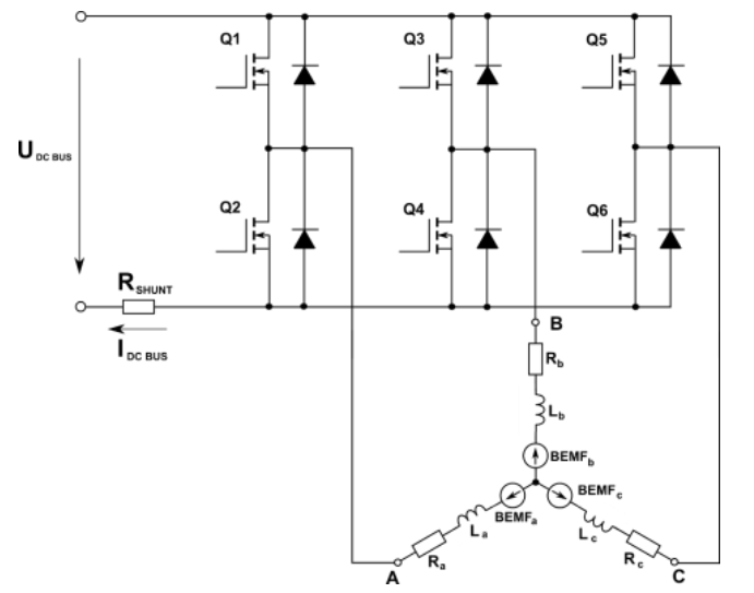

During the motor rotation.In a sector, A is connected to the positive power source and B to the negative power source.After the following commutations (A connected to the positive, C connected to the negative), there was a decay period.Now, what is the current going to be flowing in?

I mean, after commutation, what would the current loop look like during decay,

Regarding your question, I think it is dependent the current flow direction. Based on your above figure,assume at a time, the Q1 and Q4 are ON, the current flows from A phase to B phase. For example , after the commutation, if the Q5 is ON, Q1 off, the desired current flows from Phase C to Phase B, and the Phase A is unpowered, in the case, Q2 diode will flow current and decays with time, the decay time is dependent on the motor phase resistor, inductor and the momentary current(load of the motor).  For example , after the commutation, if the Q6 is ON, Q4 off, the desired current flows from Phase A to Phase C, and the Phase B is unpowered, in the case, Q3 diode will flow current and charge the DC bus, decays with time.

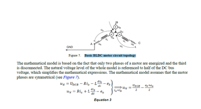

1、Is the midpoint voltage of the three-phase winding constant?for UDCB/2?
2、After Q5 is on and Q1 is off, the B phase current is twice normal?
3、The current at Rshunt is bidirectional, right?
You can check the AN12435  equation[6].
Where you can see the expression  for the voltage of the unpowered phase being equal to the  (UDBC/2) + (3/2*BEMF voltage of the unpowered phase)

3. The current at Rshunt is bidirectional, right?
Yes, the current at the Rshunt  is bi-directional.
But it is dependent on the layout and PWM waveform, based on the circuit that you provided us,
Lets take this scenario :
Assume that Q1/Q2 PWM signals are complementary, Q3/Q4 PWM signals are complementary,
Assume that at an instant, Q1/Q4 turn on, the current flows from DC bus to A winding via Q1, to B winding, to Q4, to GND to Rshunt.
At next instant, Q1/Q4 turn off, Q2/Q3 turn on, because of winding inductor, the current will keep from A winding to B Winding, this is the current flowing direction: A winding to B winding, to Q3 parallel diode, to DC bus(charging the power supply capacitor), to Rshunt, to Q2 parallel diode, to A winding.
So in ONE PWM cycle, the current flowing into Rshunt is in two directions.

1. It can be seen from AN12435 that uN = uDCB + eC / 2. So does the midpoint voltage change?
2. Assume at a time, the Q1 and Q4 are ON, the current flows from A phase to B phase. after the commutation, if Q5 conduction, Q1 is off.
Therefore, in the decay period, there is current in all three phases of A, B and C. What is the current direction on the DC bus?

Q1)It can be seen from AN12435 that uN = uDCB + eC / 2. So does the midpoint voltage change?
>>>>>Let's discuss based on Figure 7 Basic BLDC motor circuit topology in AN12435, the B phase is connected to U_DCB, A phase to GND, C phase is float. Because C phase is float, so C phase back-emf does not take effect on the middle point voltage.
As the AN points out, this is the middle point voltage, it is dependent on U_DCB,back-emf Ea and Eb.
Q2) Assume at a time, the Q1 and Q4 are ON, the current flows from A phase to B phase. after the commutation, if Q5 conduction, Q1 is off.
case 1)
In the case, before the current of A phase attenuates to zero(Q1/Q2 are always off in the step),for phase A, current flows from GND to A node via diode of Q2, to middle point. when both Q5/Q4 are on, for phase C, current flows Q5 to C node, then  to middle point. For B phase, current flows from middle point to B node to GND via Q4.
case 2)
In the case, before the current of A phase attenuates to zero(Q1/Q2 are always off in the step),for phase A, current flows from GND to A node via diode of Q2, to middle point. When both Q5/Q4 are off and Q3/Q6 are on, for phase C, current flows from GND to C node via diode of Q6, then to middle point. For B phase, current flows from middle point to B bode, to DC bus via diode of Q4.

I post the middle point voltage formula here:
