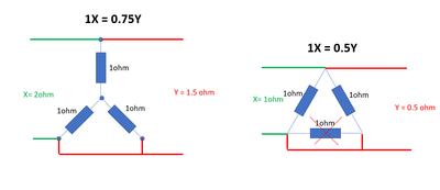

I need some clarification on the document below for calculating parameter manually.
I am following the AN4680 document, which describes the following for calculating Back-EMF. It is stated, "For three-phase measurement if the neutral point is not accessible, it’s possible to create the artificial neutral point from all three voltage probe clips connected together". I did the connection as given below(Fig.1 assuming the Motor has star topology).
Fig. 1
Note: I am working on motor control for Igus MOT-EC-60-CIA (3 phase EC/BLDC Motor,NEMA24) motor using RT1050-EVK-B and FRDM-MC-LVPMSM. 
  1. Motor Parameter
1.1)How to check if the Motor have Star or Delta Topology?
1.2) Does the measured Vpk-pk correspond to phase-neutral or phase-phase voltage?(Unknown: Motor have Star or Delta Topology)
1.3) If it is Phase-Phase Voltage, can it be converted to Phase-neutral voltage by using the following formula,
                    Van= {Vab/sqrt(3)}   ------------------------------------------- [1]

Here are some answers:
1.1) Try the following test:
1.2) At the star topology it corresponds to phase-to-neutral voltage.
2.1)
Undervoltage fault: is triggered when the DCbus volateg drops under a certain level. On FRDM-MC-LVPMSM use 24VDC.
Overcurrent fault: is triggered when DCbus current goes over a certain level. This fault is done using MCU peripheral interconnection: DCbus current analog value is brought to comparator(CMP), CMP output is brought to PWM fault input which can (in case of fault) immediately turn off PWM outputs. Overcurrent fault threshold is fixed and can be changed in code only.
