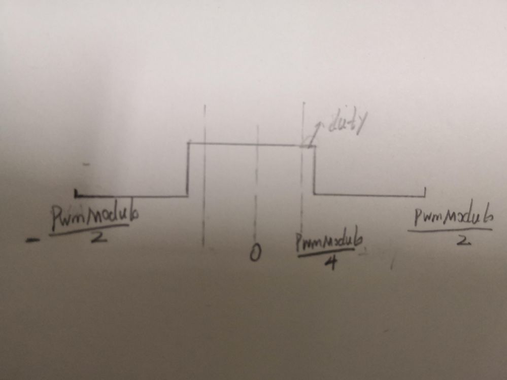

xgy_upc
In McDrv_pwm3ph_ftm.c in bldc_ref_sol, there is a MCDRV_FtmSetDutyCycle function, which I'm not sure about the duty cycle Settings.
i16Duty = MLIB_Mul_F16((i16InpDuty), (this->ui16PwmModulo) / 4);
i16FirstEdge = -(this->ui16PwmModulo) / 4 - i16Duty;
 i16SecondEdge = (this->ui16PwmModulo) / 4 + i16Duty;
I think the PWM waveform generated by this setting is shown in the figure below.So the final duty cycle is not consistent with the duty cycle of the input function.I want to know where did I get it wrong?

Hello 相国 尹,
As the function mention, the input duty cycle is an escalated frac number so the -1 = 0% and +1 = 100%. So the value need it for the 20% is FRAC(-0.6).

Alexis_A
Hello 相国 尹,
What did you draw is correct, by default, but as the description mention the i16InpDuty should be a fractional number between -1 and 1, and the multiplication function will escalate the value to match the appropriate module. So if the value if -1 the PWM duty will be 0% and if the value is 1 will be 100%.

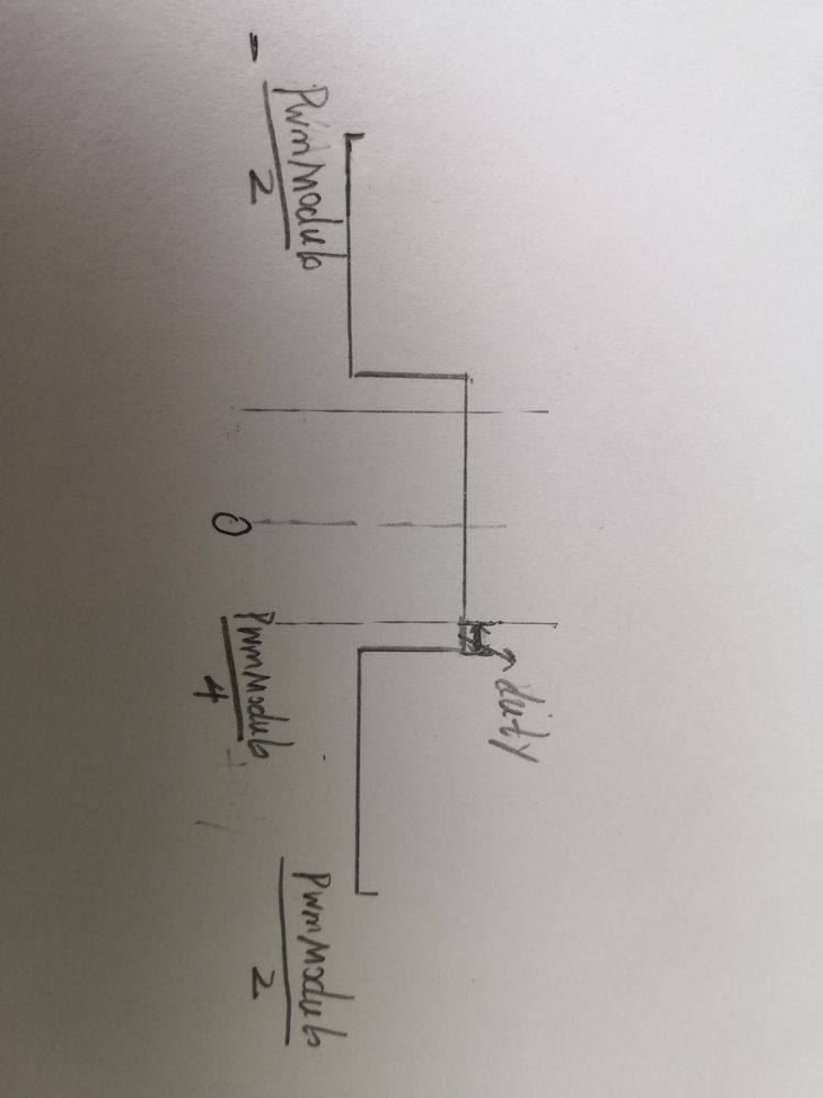

xgy_upc
I know that i16InpDuty is a fraction and a numerical match.Did you notice that the duty cycle of PWM wave I drew is different from the duty cycle of function input?For example, the duty cycle of the function input is 20%, but the duty cycle of the PWM wave I have drawn is 60%IMG_20200806_094554.jpg

Alexis_A
Hello 相国 尹,
In this case that you want the 20% duty cycle, what is the value that you put in the i16InpDuty that corresponds to 20%?
Alexis Andalon
8,579 Views
xgy_upc
Hello  Alexis Andalon,
The value  is FRAC(0.2)  in the i16IputDuty.
xiangguo
8,579 Views
Alexis_A
Hello  相国 尹,
Try with FRAC(-0.4).
Alexis Andalon
8,579 Views
xgy_upc
Hello,Alexis Andalon
if I use the FRAC(-0.4),the final duty cycle is 30%. As the function,the duty cycle of input should be the final duty cycle of PWM.
xiangguoyin
8,580 Views
Alexis_A
Hello 相国 尹,
