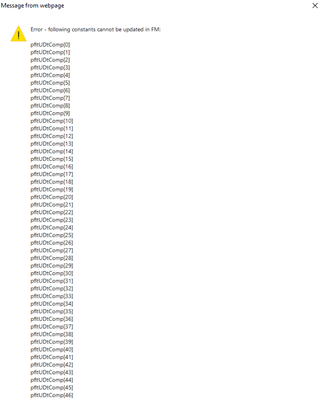

Krish403
I am using MIMX1024-EVK with FRDM-MC-LVPMSM board. I am trying to run the PMSM demo project. Communication between the PC and EVK is working but when I drag and drop the .pmp file from the MCUxpersso IDE v11.4.1 to Freemaster 3.1 I am receiving the below error message. Could you please help me with this error?
Thank you in advance.
When I select Yes, below error message showing:
8 返答(返信)
10,642件の閲覧回数
joseftkadlec
Hi Krish403,
This error message is caused by an MCAT (motor control html+js script running in FreeMASTER). We are trying but can't reproduce your issue, trying various clicking in MCAT. Could you please describe the sequence how to reproduce the issue? Which buttons do you click in MCAT or does the message appear right after starting the FreeMASTER communication (gree GO button)?

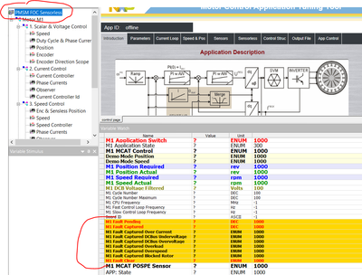

Krish403
Hi, thank you for the response. Somehow, I have resolved from the previous mentioned error. But now I am receiving new errors. I am following the below process to run the demo mc_pmsm SDK project.
  • I have downloaded MIMXRT1024 SDK.
  • Drag and dropped the SDK to the MCUexpresso IDE.
  • Imported SDK project from demp_apps_ mc_pmsm.
  • Automatically project added to the workspace as evkmimxrt1024_mc_pmsm.
  • Build and debug the project. And terminated IDE, to connect the freemaster.
  • Connected to the freemaster using connection wizard.
  • Drag and drop the .pmp file from the IDE (evkmimxrt1024_mc_pmsm> motor_control> freemaster> pmsm_float_enc.pmp)
  • Entered motor parameters, updated target, and generated configuration file.
  • App Control tab showing attached errors. I was unable to clear the fault. Unable to turn on Demo Mode On/Off. (Icon was disabled).
  •  Due to this, I was unable to run the motor.
Could you please help me with this issue?

joseftkadlec
Hi Krish,
I have several points:
  • It shouldn't be necessary to use the FreemASTER's connection wizard, just click the GO button.
  • If you are using the default Teknic motor (are you?) the application is already tuned and there is no need to enter parameters and update target.
  • If you want to tune the application for your own example, this is a more complicated process. Please follow the Chapter 9 in docs/MC/3PPMSMCRTUG.pdf
  • Regarding the fault: check the fault numberjoseftkadlec_0-1633694112489.png
  • After fault condition disappears, the application goes back to STOP state automatically and the fault number is captured for later debugging.
Let me know your comments,
Thank you,
Josef

Krish403
I am using LINIX motor( part number: 45ZWN24-40). Assuming I can use the LINIX motor without  changing any motor parameters.
I have followed the process as you mentioned (GO button). After that window popped up.
Here I have selected symbol file from the evkmimxrt1024_mc_pmsm_1 > Debug > evkmimxrt1024_mc_pmsm_1.axf.
File format: Binary ELF with DWARF2/DWARF4 dbg format.  Please correct me if I am wrong.
After this I am dragging the .pmp file to freemaster. Here is the fault number: 4
Fault is not disappeared when I press CLEAR FAULT.
Please let me know your comments.
