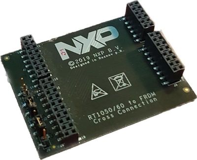

Resulted board:
2. Compatibility
This table describes the compatibility of i.MX RT EVKs supporting Motor Control examples.
EVK
Wiring needed
evkmimxrt1010 Works without extra wiring and without Interconnection board
evkimxrt1020 Needs extra wiring, no Interconnection board
evkimxrt1024 Works without extra wiring and without Interconnection board
evkimxrt1040 Works with Interrconnection board
evkbimxrt1050 Works with Interrconnection board
evkimxrt1060 Works with Interrconnection board
evkbimxrt1060 Works with Interrconnection board
evkcimxrt1060 Works with Interrconnection board
evkimxrt1064 Works with Interrconnection board
evkmimxrt1160 Needs extra wiring, no Interconnection board
evkmimxrt1170 Needs extra wiring, no Interconnection board
evkbmimxrt1170 Works without extra wiring and without Interconnection board
evkmimxrt1180 Works without extra wiring and without Interconnection board
