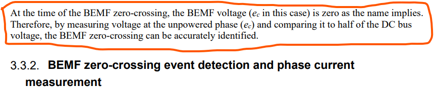

4) What the below sentence means is, ‘Measure the BEMF voltage(ec) in a phase where power is not supplied and find the moment when BEMF voltage(ec) reaches 0V'. That is, finding the point where Uc = 1/2Udcb. Am I right? (or Does it mean comparing BEMF voltage and DC bus voltage?)
I mean What voltage is measured? regarding the following sentence 'by measuring voltage at the unpowered phase (ec) and comparing it to half of the DC bus voltage,'

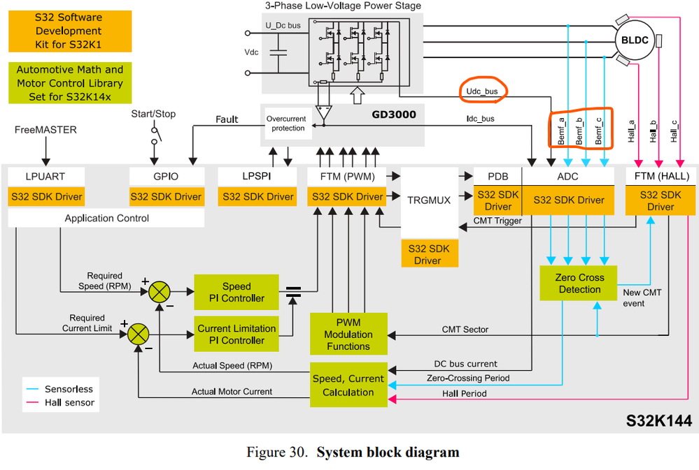

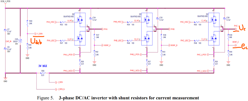

5) Considering Figure 5 and Figure 30, it seems that all three DC bus voltage (Udcb), BEMF voltage (ec), and Phase voltage(Uc) are measured. And it seems that the three measured voltages are compared as in Equation 6. Is that correct?
[Figure5. 3-phase DC/AC inverter with shunt resistors for current measurement]
[Figure30. System block diagram]
You measure induced voltage on unpowered phase.
Sorry, I dont understand your understanding.
In case you never worked with sensor-less motor and you are going to design control circuit. I strongly recommend you to undergo some basic training and also have a look at our reference examples.
We have posted dozens of application notes on this problematic.
