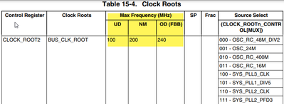

How fast are you able to calculate full sensorless foc for pmsm? Are you able to do it in less then 5 microseconds on single core?

For Motor Control is recommended to use the eFlexPWM module, it is limited by its clock root. And taking this into consideration, any i.MX RT Crossover MCUs can meet your needs.
In Clock Controller Module (CCM) chapter from any RT reference manual you can see a table which specify which clock root use each module. And a little later you can found another table that states their maximum frequency. For example, for RT1170:
Table's names vary in each manual but all are in CCM chapter.

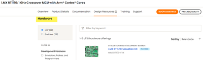

Thank you to pointing me! I'd like to try it out, is there a low-cost dev board, aka USB stick size?

You can check the EVK available for each device in the Hardware section from its page. For example:
Most likely there are other dev boards from third parties that use our devices, but you would have to search for them on your own. (I hope you understand that this is out of our scope.)
