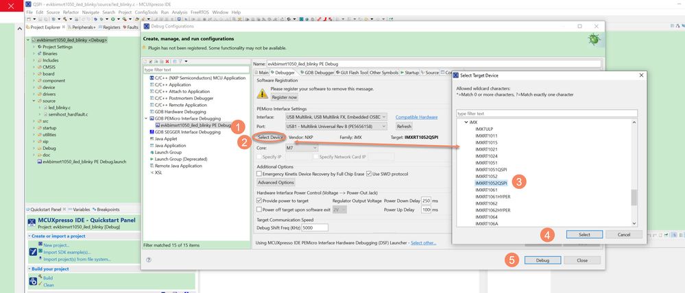

kerryzhou
Hi @gianpiero_lenta ,
   Thank you for your interest in the NXP MIMXRT product, I would like to provide service for you.
   To the PE micro connect the mcuxpresso RT1050, the default setting is for the hyperflash, that's why your MIMXRT1050-EVKB works, as that is using the hyperflash.
   If you want to use the RT1050 QSPI flash for the PE micro in the mcuxpresso, please use this setting, then your flashdriver will use the qspi firmware:
You also can check the download log,  you will see it calls the qspi firmware like this:
I have tested it on my MIMXRT1050-EVKB board which is modified to the qspi with pemicr debugger in the previous time.
Wish it helps you!
If your question is solved, please help to mark the correct answer, just to close this case, thanks.
Kerry

gianpiero_lenta
I tried with your advice but it continue to fail, please look at the log attached.
