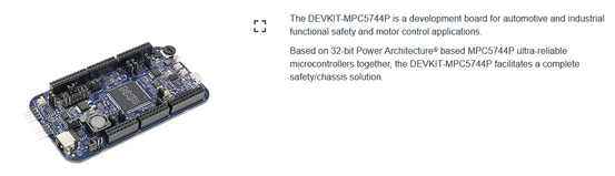

I will reform my question. Right now I am using the power stage  Motor GD DevKit with MPC5744P EVB rev. E. Is there any other power stage, which is compatible with MPC5744P (just plugin) and has more power?

Yes, there is possibility but it will require some effort.
You can use MPC5744P EVB rev. E board, I expect you are referring to this one:
You can connect this board to power stage via PCI:
https://www.nxp.com/design/designs/3-phase-reference-design-for-hybridpack-drive-igbt-sic-module-fea...
you will need to cut the PCI cable and inset the wires into the devkit board connector. (the connector is standard)
Or to the :
https://www.nxp.com/design/designs/3-phase-reference-design-for-hp-drive-featuring-gd3160:RDGD3160I3...
Where you will need inverted from infineon: (for example)
https://www.digikey.at/de/products/detail/infineon-technologies/FS820R08A6P2BBPSA1/7324175?utm_adgro...
This one is compatible with our boards, so you will just push and connect it to it.
But all of this depends on the project budget and will require addition effort to get it running.
This is just a brief overview on possible solution.
Peter
