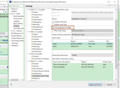

Good morning,
we are having a strange problem with the "Quad Motor Control Development Platform".
This platform consists of three boards (equipped with an i.MX RT1052) already developed by NXP and the management software also developed by NXP to allow the control of up to four brushless motors.
The problem that until now we have not been able to solve is debugging the application with PE micro, it seems that it cannot load the application or it loads it partially or incorrectly.
It all works using LPC Link2 but not Pe micro.
Pe micro works correctly on EVKBs (with 1052 on board)!
The big difference between the 2 evaluations is this:
1) EVKB defaults to Hyper Flash
2) Quad motor goes on quad SPI
Has anyone faced similar problems?
Thanks in advance

Hi @gianpiero_lenta ,
  What's the QSPI flash chip you are using, it is new, right?
   Please tell me your QSPI flash chip partnumber at first.
   Please check whether you can download the code to the internal RAM,
if yes, you can download this code:
\SDK_2_11_0_EVKB-IMXRT1050\boards\evkbimxrt1050\driver_examples\flexspi\nor\polling_transfer
to the RAM,
Please also check your QSPI flash chip, if it is not the same as the MIMRT1050-EVKB board, then you need to follow your QSPI flash datasheet to modify the LUT command, and test it.
For the new chip, you need to enable the QE bit.
Test the polling_transfer project, whether you can finish the flash chip erase, write and read.
Please test it.
Kerry

gianpiero_lenta
Hi @kerryzhou ,
thanks your advice was invaluable.
Now it works, we can debug with Pe Micro.
We had been circling this issue for a few days.
It is still unclear how we got into a similar problem, for some reason the QE bit probably gets dirty.
Either by mistaking the flash in the initial settings or by trying alternately LPC link 2 and pE micro something not under control happens.
To allow everything to work we still had to add the "erase all" flag of the form I attached to you.
Anyway we still continue to investigate how the problem arise.
many thanks

kerryzhou
   Thank you for your interest in the NXP MIMXRT product, I would like to provide service for you.
   To the PE micro connect the mcuxpresso RT1050, the default setting is for the hyperflash, that's why your MIMXRT1050-EVKB works, as that is using the hyperflash.
   If you want to use the RT1050 QSPI flash for the PE micro in the mcuxpresso, please use this setting, then your flashdriver will use the qspi firmware:
You also can check the download log,  you will see it calls the qspi firmware like this:
I have tested it on my MIMXRT1050-EVKB board which is modified to the qspi with pemicr debugger in the previous time.
Wish it helps you!
If your question is solved, please help to mark the correct answer, just to close this case, thanks.
Kerry
