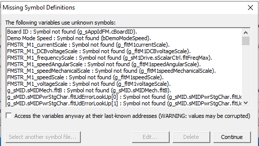

I got example in SDK
while using example in freemaster it is showing missing symbol veriable how to handle it

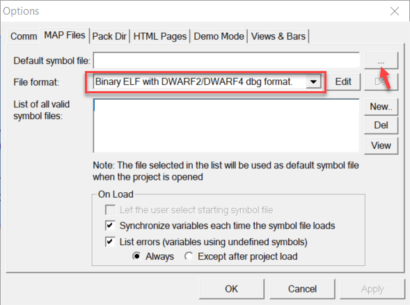

You need to select the .axf file as follows.
In Freemaster go to Project > Options and then click the MAP files tab. Then in Default symbol file select your .axf generated in the Debug folder of your SDK project.
Finally select File format as Binary ELF. Please check the snippet below.
