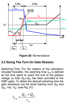

Hello, I need help choosing an IGBT gate driver IC and the application is focused on a 3-phase AC motor inverter setup. Consider it is a 5 pole pair motor and needs to run at 5000rpm. Then what should be my gate driver's Tsw to switch on the IGBTs?
As we know the current supposed to be supplied to the IGBT should be
Current = Gate charge(Qg) / Tsw
I need to filter some gate driver ICs which should be able to supply the current, but I can proceed with it only if I know the Tsw and I have no idea how to calculate it for the application so that the motor runs at the desired RPM (mentioned above).
It'll be helpful if someone can share any formula or application notes which can guide me to find it.
Thank you in advance.

Hey, thanks for the reply, I would like to know more about the GD3100
In the datasheet of the device, it was given that its compatible with IGBTs of 200-1700V range, however, I did not find any information in regards to the following:
1. In a Half-Bridge configuration, the high-side IGBTs' source is connected to the Gate Driver, and in case of a high power application, the source terminal will be at a high voltage (270+ volts). My query is would this gate driver be able to handle the voltage levels of the high side IGBTs' source connection. Thanks

It is a pleasure to assist you.
You are correct, the GD3100 is capable of directly driving gates of most IGBTs and SiC MOSFETs.
Do you mean collector to emitter breakdown voltage? In that case, it is compatible with 200 V to 1700 V IGBT/SiC, power range (125 kW).
The GD3100 Half-Bridge Evaluation Kit might be useful for you as a reference for your design.
Please let me know if this information helps.
