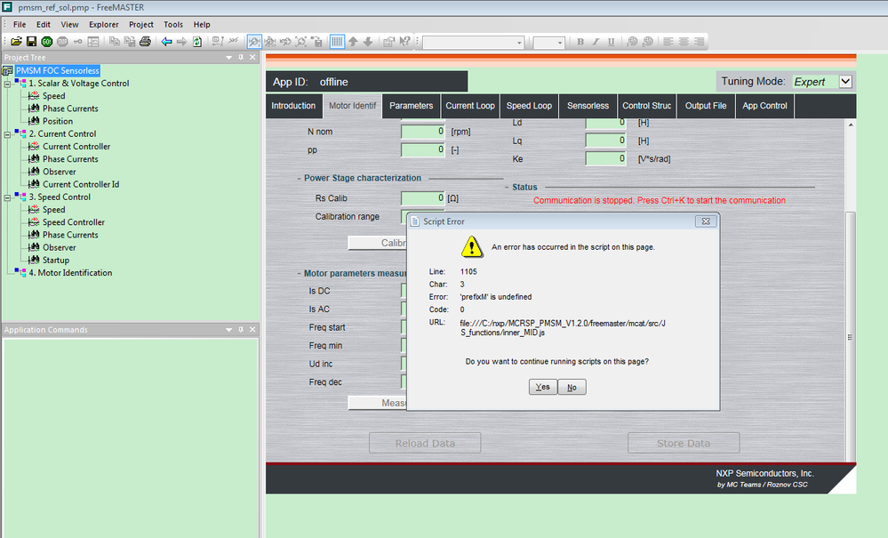

cliHello,
  I am in the process of doing some fine tuning on some custom hardware and motors.  Sometime back I had used the Motor parameters measurment utility in the MCAT pmsm_ref_sol.pmp application from the MCRSP_PMSP_V1.2 installation.  For some reason now every time I try to use this utility I get the following error when I click Measure...?
Any idea of how to fix this?  This was a very useful utility to measure custom motor parameters quickly and easily.
Frank

Hi Frank Roberts ,
    Could you please also give me MCRSP_PMSP_V1.2 download link in the nxp.com?
    Do you mean, it works in the previous time, but for some reason, it meets the script issue, right?
    Do you try to uninstall it, and install it again, any improvement?
Wish it helps you!
Kerry

Hello Kerry I have not tried to uninstall this as of yet as that seemed liked kind of a harsh/sledgehammer method considering everything else in the Freemaster GUI is working as expected.  YES this Motor Identification functionality worked no less than about a month or so ago and now it does not work as I have shown above.
My question is whether someone can tell me if it requires a specific version of Java to be installed?  I.E. - I know my PC updated Java within the last month to the latest Java version.
 You can find the link by searching for MCRSP_PMSM on the NXP website.  There is an older version V1.1.2 and the newer version that I am using V1.2 with the link below...
https://www.nxp.com/downloads/en/reference-applications/MCRSP_PMSM_V1.2.0.exe
Frank

  I checked the MCRSP_PMSM v1.2.0 release note, which freemaster version you are using?
2 Development tools
The NXP MCRSP_PMSM v1.2.0 was compiled and tested with these development tools:
 IAR Embedded Workbench IDE v7.70.2
 Kinetis Design Studio IDE v3.2
 ARM-MDK - Keil® μVision® version 5.21
For the application capabilities demonstration, the following tool is required to be installed:
FreeMASTER Run-Time Debugging Tool 2.0.2.4
My freemaster version is v2.5, I really also reproduce your issue:
Please help to check your freemaster version, maybe it is related to the freemaster version.
Then I will check the internal side.
BTW,do  you try to click yes? it seems after click yes, the measure still can be clicked.
Wish it helps you!
Kerry

Hello Kerry,
  I am using FreeMASTER Version 2.0.9.  I think we are missing the point that this all worked fine no less than ~3-4 weeks ago and the rest of the pmsm_ref_sol.pmp is still working fine just this Motor Identification tab is not working.  I have not changed/updated my FreeMASTER version since this was working sometime back...let me try to uninstall and re-install and see what happens.  It still seems highly suspicious that my computer recently went through a Java Installation update and this stopped working in which it certainly appears to be a Java Script.
