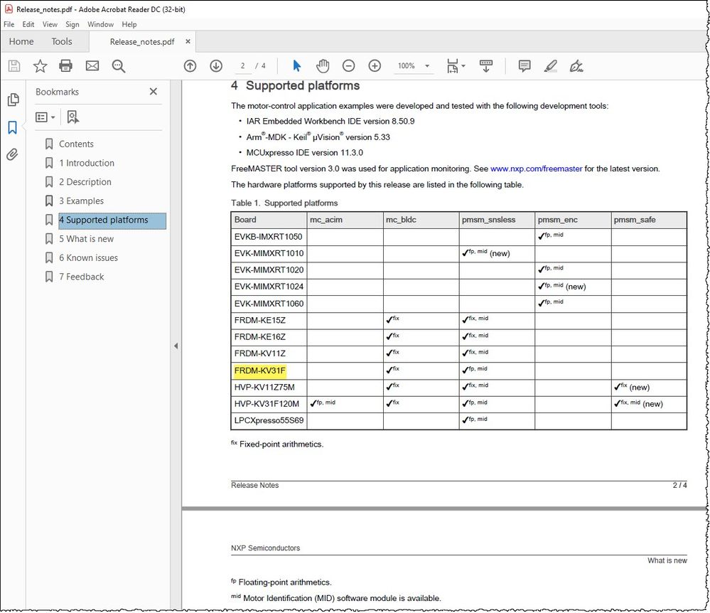

I found the following application note : AN12374 in order to start a project using the FRDM-KV31F kit but I can't find the PMSM package that contains all the reference designs. Where can I find it?
Using the SDK Builder for FRDM-KV31F, I got the 2.9 version but I can only find the demo_apps/mc_pmsm/pmsm_snsless for sensorless FOC application. Release Notes v2.8.0 says that pmsm_enc and pmsm_safe should be there too.
Thanks!
2,484 Views
Robin_Shen
Hi madoyon,
I am sorry to tell you that the pmsm_enc and pmsm_safe are not support for FRDM-KV31F board right now.
You can find the hardware platforms supported by this release are listed in the following table:
Robin
