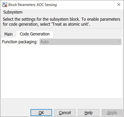

Hello!
I am using Matlab Simulink R2019a and stepped through the 3-Phase PMSM Control Workshop (-Phase PMSM Control Workshop with NXP's Model-Based Design Toolbox ).
I automatically converted the project to be compatible with the newer Matlab version.
I had to fix the following error:
FTM PWM Disable Enable block 'ADC_Sensing/S32K14x EVB/FastLoopControl/PWMCommands/Control_Logic/t2_init/FTM_PWM_Disable_Enable' has no FTM PWM Config block
This was done quite easily. I had to change the Module from 0 to 3 in all "FTM PWM Enable Disable" blocks.
The problem now are compiler errors.
Unfortunately I can't get the Modules M6, M7, M8 and M9 running due to compiler errors now.
The errors are getting longer and longer from M6 to M9.
The errors for M6 are this:
In file included from pdb1_isr.h:2:0, from ADC_Sensing.h:44, from ADC_Sensing.c:19: ADC_Sensing_private.h:91:24: error: unknown type name 'rtDW_ComputeElectricAngle_ADC_Sensing_g_T' real32_T *rty_theta, rtDW_ComputeElectricAngle_ADC_Sensing_g_T *localDW); ^~~~~~~~~~~~~~~~~~~~~~~~~~~~~~~~~~~~~~~~~ ADC_Sensing_private.h:92:52: error: unknown type name 'rtB_SPI_Comm_ADC_Sensing_g_T' extern void ADC_Sensing_SPI_Comm(uint8_T rtu_Data, rtB_SPI_Comm_ADC_Sensing_g_T * ^~~~~~~~~~~~~~~~~~~~~~~~~~~~ ADC_Sensing_private.h:117:3: error: unknown type name 'rtDW_SlowLoopControl_ADC_Sensing_T' rtDW_SlowLoopControl_ADC_Sensing_T *localDW, real32_T *rtd_SPEED_CMD, real32_T ^~~~~~~~~~~~~~~~~~~~~~~~~~~~~~~~~~ gmake: *** [ADC_Sensing.o] Error 1
How can I solve this error? Is it due to compatibility problems with R2019a?
.. is caused by the Matlab Code generator. It does not like the atomic subsystems.
An easy workaround is to change all the atomic subsystem from the motor into non-atomic with Code Generation function packing set to Auto

I am using version 4.1.0 of the MBDT.
The function packaging of the block "ADC_Sensing > S32K14x EVB > ADC Sensing > ADC1_IRQHandler" is already set to "Reuseable function". I played around a little bit with some other options and other functions and blocks, but I could not get rid of the error.

The PWM Enable Disable block must be used alongside with a PWM config block for a certain module, as you've already done.
What MBDT version are you using?
Form the provided log, I assume that inside of the s-function triggered by the PDB interrupt block, there are some ADC read blocks used, so I assume that changing the Code generation function packaging from Auto to Inline or Reusable function might solve your problem.
