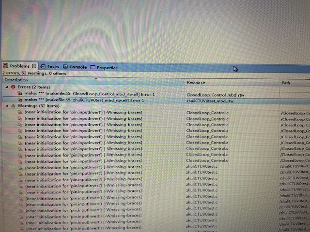

18226635115
Hello Razvan,
After I changed S32DS for PA from v2.1 to  v 2017.R1,prombles like ''Ld error: cannot specify -o with -c, -S or -E with multiple files"disappeared,but there is a new error happened which you can see in the attachment.
Can you give me some advice to solve the problem.
I am looking forward to your reply.
Thanks  very much.
Havry
6,685 Views
e_bashar
Hello Havry,
I think you might need to change the target processor to "generate code for E200Z4".
Project setting>C/C++ Build>Settings>Target Processor and then changing the the target processor. Also you should reselect the libraries support.
Erfan
