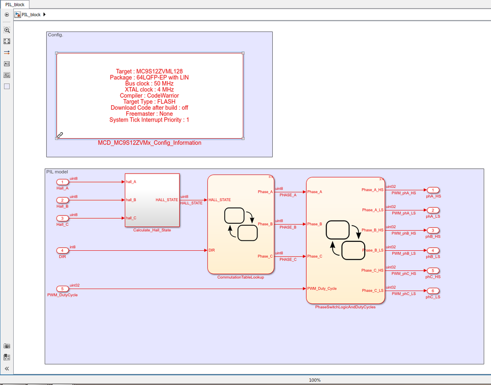

I adapt the example model (Lecture7_MPC5744P_v3.2.0.zip) to use with S12Z. But somehow it does not work.

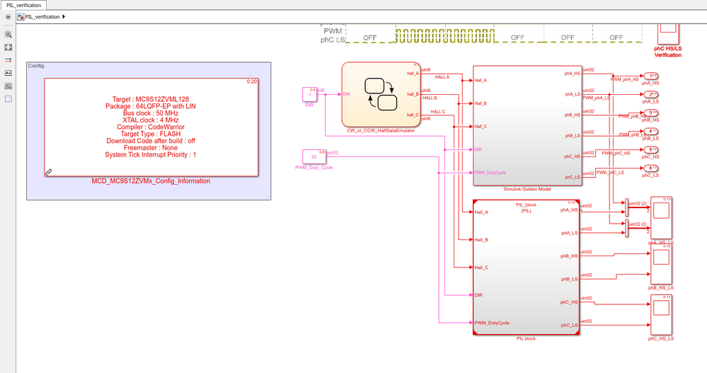

Top Level Model:
PIL_block:

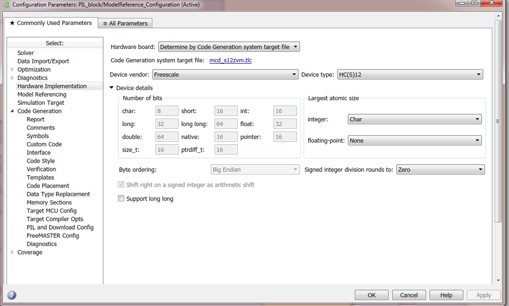

Configuration Parameters setting is the same for both Top level and PIL Model:

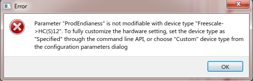

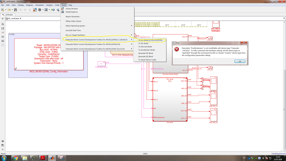

When I do the step "Tools/..../To PIL Mode on S12Z", I get error:
Could you help me please?
Toolchains:
Matlab/Simulink 2017a
Motor Control Development Toolbox for MagniV S12Z    Version 1.3         (R2013a-R2015b)
Code Warrior Version: 11.0.1
Many thanks in advance!
Tony
2,082 Views
ngoctuhoang
Maybe is helpful for someone newbie like me in NXP-S12Z MBD Toolbox.
I try with Matlab 2015a, and It works.
