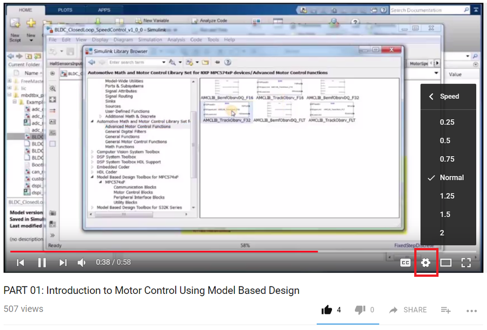

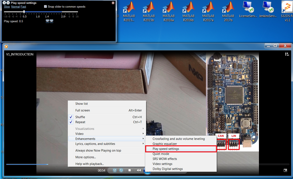

   Thank you for answering me!I have watching the Motor Control Class: Lecture 1 - Introduction  video tutorial,but it play too fast.
Can you provide normal speed video?
best regard
robin
3,404 Views
Daniel_Popa
Hi Robin,
I've speed up in the videos only the "boring part" or parts that are usually duplicated between lectures.
If in general you find the video to fast - then if watching on Youtube PART 01: Introduction to Motor Control Using Model Based Design - YouTube you have the option to show down it automatically:
On YouKU, i do not know - but i presume there might be something similar.
In any cases, if you download the video on your PC you could use the Windows Media Player Speed Settings to reduce the playback speed.

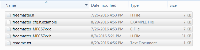

Thank you for answering me!How Can I  add freemaster on my own application project, I use the MPC5744 chip
best regard
robin
3,404 Views
Daniel_Popa
Hi Robin,
The FreeMASTER has 2 parts:
    - the host PC application (the GUI that you see on your computer)
    - the embedded communication driver.
Depending on the platform you have, the embedded driver might be different. The driver for MPC5744P can be downloaded from here: FreeMASTER Communication Driver
if you download and install the package you will find these files.
You will need to link these files with the rest of your project. Please check the readme.txt and you will find all the information how to do that.
