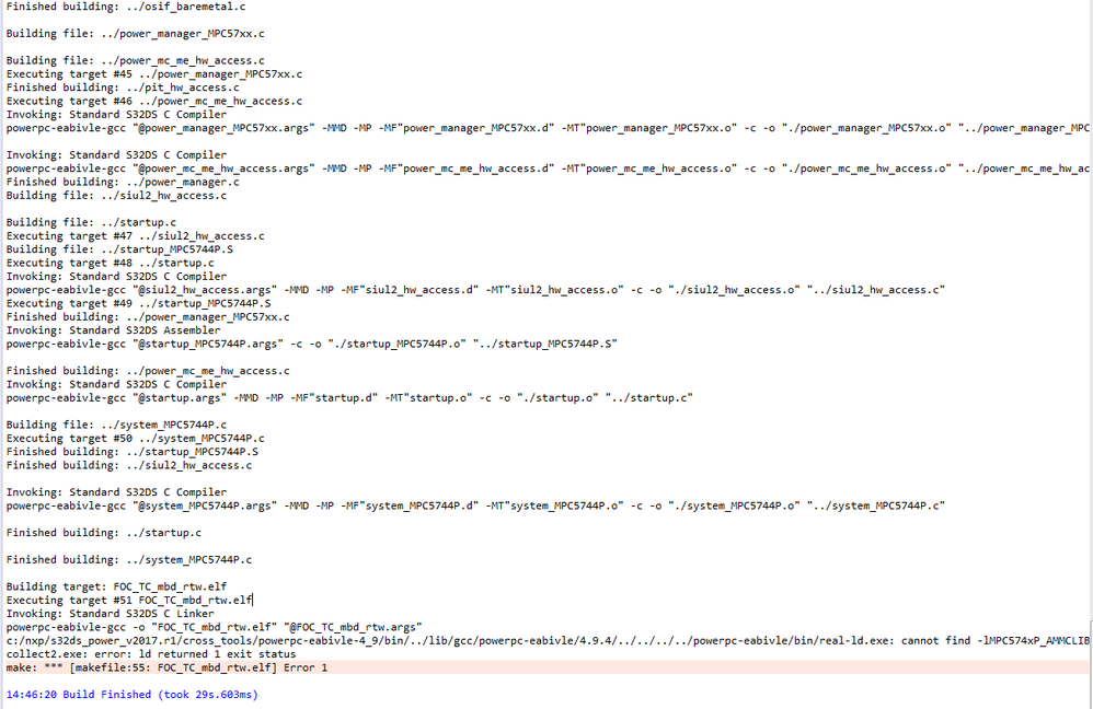

I have actually imported a generated code(PMSM Module 7:Torque Control ) from Matlab to the S32 Design software by following the below form instructions:
How to export Generated Code to S32 Design Studio IDE (applicable for MBDT for MPC5744P v2.0)
But when I build the code I will get the following errors:
make:***[makefile:55:FOC_TC_mbd_rtw.elf]Error 1
Console implies "cannot find MPC 574xP_AMMCLIB.a'',actually i set the library for MPC 574xP_AMMCLIB.a.
But it's ok for the generated code of lesson 12 Motor Control System
Software version information i use as below:
MBDToolbox  MPC57xx V3.0
S32 Design Studio for Power Architecture Version 2017.R1
I upload some snapshots about build errors occured and settings for S32 DS,maybe you can give me some advices.

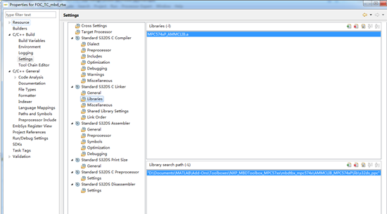

Hello [email protected]‌,
I'm sorry but I can't read the linker options on the image you uploaded - could you write them in a comment here? You might not have a correct path for the AMMCLib set - given with the -L option in S32DS.
You can share your S32DS project and I can import it and try to figure out what's going on.

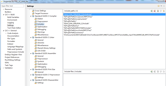

After i imported  project.xml file to s32DS,I changed two project settings as below:
1、Project >C/C++ Build>Settings>Standard S32DS C Compiler >includes
I remove the item "D:/Users/Administrator/Add-Ons/Toolboxes/NXP_MBDToolbox_MPC57xx/tools/Cross_Tools/powerpc-eabivle-4_9/include" ,and
add my own NXP MBDT path ,"D:\Users\Administrator\Add-Ons\Toolboxes\NXP_MBDToolbox_MPC57xx\mbdtbx_mpc574x\AMMCLIB_MPC574xP\include"
2、Project >C/C++ Build>Settings>Standard S32DS C Linker >libraries
In the libraries(-l)  ,i add "MPC574xP_AMMCLIB.a"
in the library search path (-L),I add my own NXP MBDT path "D:\Users\Administrator\AddOns\Toolboxes\NXP_MBDToolbox_MPC57xx\mbdtbx_mpc574x\AMMCLIB_MPC574xP\lib\s32ds_ppc"
After that ,i build the project ,the error i mentioned occur.
