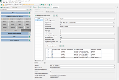

I'm working with iMXRT1062 and can't get ADC2_IN1 (Pin H12) to correctly read a voltage input using ADC_ETC in MBDT.
In total I'm measuring 12 pins and I only have issues with ADC2_IN1, the other pins measure fine.  I'm also measuring most of the pins in ADC1 and a higher sample rate.
The setup is based off the example "ADC_ETC_Hardware":
I can measure on the pin with a multimeter and there is no issue in the hardware.  I can also take the "ADC_Polling" example and measure on ADC2_IN1 without issue.  I know the issue is in the software and not in the hardware.
What is the issue in my setup using ADC_ETC?
Attached my config files based off "ADC_ETC_Hardware" and "ADC_Polling"
