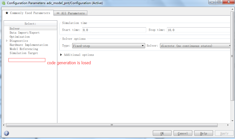

configuration parameters don't include code generation,what‘s the reason?
8,926 Views
jinhui_wu
configuration parameters don't include code generation,what‘s the reason?QQ截图20170622113547.png
8,238 Views
constantinrazva
Hi jinhui.wu‌,
You can also try this command:
license('checkout','RTW_Embedded_Coder')
in your Matlab command prompt and verify that the return value is 1. If that's not the case, Simulink is experiencing problems while checking out the license for Simulink Embedded Coder.
Razvan.

jinhui_wu
Trial>> ver
MATLAB 版本: 9.2.0.556344 (R2017a)
MATLAB 许可证编号: DEMO
操作系统: Microsoft Windows 7 专业版 Version 6.1 (Build 7601: Service Pack 1)
Java 版本: Java 1.7.0_60-b19 with Oracle Corporation Java HotSpot(TM) 64-Bit Server VM mixed mode
MATLAB 版本 9.2 (R2017a)

jinhui_wu
Troubleshoot this issue by visiting:
http://www.mathworks.com/support/lme/R2017a/5
Diagnostic Information:
Feature: RTW_Embedded_Coder
License path: C:\Users\jinhuiw\AppData\Roaming\MathWorks\MATLAB\R2017a_licenses;C:\Program Files\MATLAB\R2017a\licenses\license.dat;C:\Program Files\MATLAB\R2017a\licenses\trial_4132165_R2017a.lic
Licensing error: -5,357.
ans =
0
Trial>>
8,238 Views
Daniel_Popa
Hi jinhui.wu‌,
What is the name & version of the toolbox you are using ?
What is the return value of this command license('checkout', 'real-time_workshop') in your Matlab command prompt ?
If you don't see 1 as the return value, you are probably not seeing the Code Generation pane in the Configuration Parameters window because Simulink is unable to check out a license for Simulink Embedded Coder (formerly known as Real-Time Workshop).
Please run command ver and paste its output here as well.
Hope this helps!
8,236 Views
jinhui_wu
hi daniel:
   the reason should be that Simulink is unable to check out a license for Simulink Embedded Coder.
   how can i solve this problem?
8,238 Views
Daniel_Popa
Hi jinhui.wu‌,
You will need to buy one from Mathworks. I'm afraid we can't help you in this matter - Embedded Coder is a general pre-requisite for Matlab to generate the C-code.
Hope you will find a way to acquire such license.
8,236 Views
jinhui_wu
daniel:
   thank you,i have already connect mathworks.
   they say:According to the output of ver command, you have not installed Simulink Coder or Embedded Coder. I also checked your trial license and found that it does not include these two toolboxes.
   so i need buy these two toolboxes!
   i am trying other way,thanks you very much for your help!
